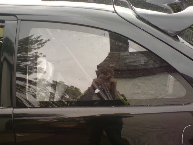

finally got my windows in.little change of plan for a engine.....got one thats 130bhp but gunna put wossiner pistons in it a vvc head.. should give me a good relible fiigur..also migth of got a set of speedlines for it same as my dads, moneys really tight now with me beign at college but hey ho!

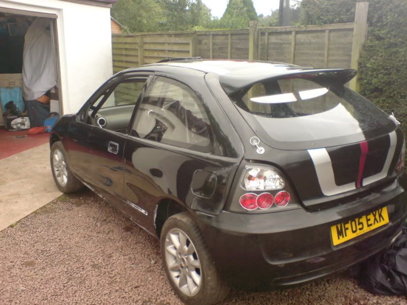

some more updates whilst i had a day off...
painted my fogs to match the car
made my boot stay cause of the fiberglass bootlid
finished my centre console ...
then started to refurb my calipers and paint some other stuff
this is teh caliper half stripped down
mg zr rally car
2,076 Posts
got otehr stuff ....such as a mk2 handbrake painted in anthracite.
finishd my jack off today now ive got to mount it onto the car
got some of my underbody protection cut for the side of teh car..
got a set of wingmirrors from the scrappies...migth get a set of carbon f1 ones but not sure yert
everythings taking shape....comments as usual!
