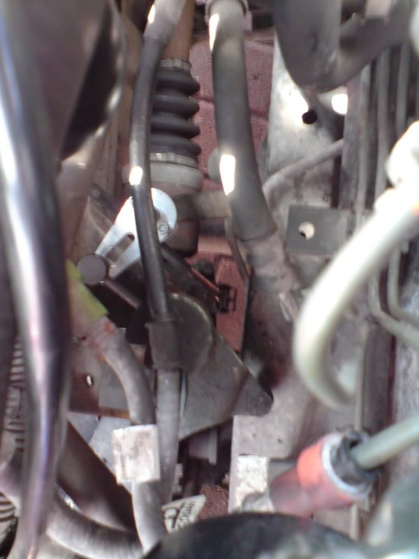

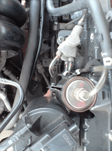

1 - Pop your bonnet and locate the gear linkage. If you stand at the passengerside of the car and look directly under the fuel filter, you will see it.
(the flashing skull and crossbones in pic)

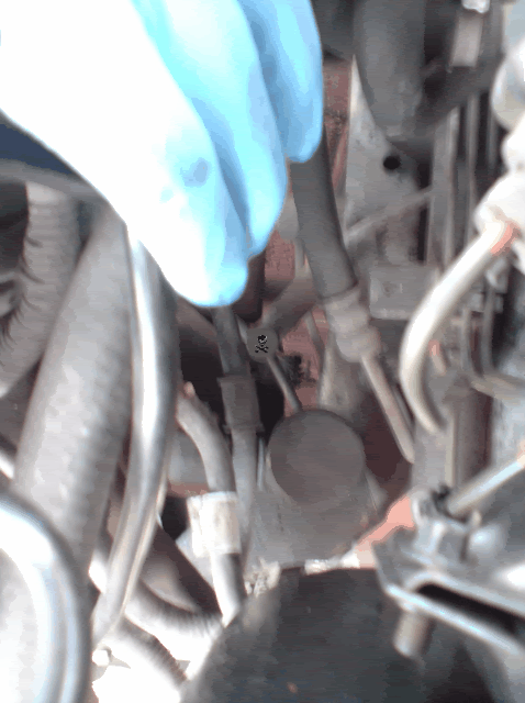

2 - Move the coolant pipe out the way and u will see a smaller circle. This is fixed onto a ball joint. What you need to do prise this apart. i found using a flat blade screwdriver and levering it off is the best way
3 - you will then be left with the ball joint (see pic below). What you need to do now is use the ball joint on the shortshifter and fit it to the small circle (the one we levered it off earlier)[/B]

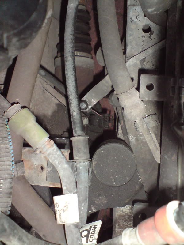

4 - Using the other size of the shifter, put it over the orignal ball joint and then clamp it in place by using the 2 nuts and bolts provided.
it should look something like this once fitted[/B]
