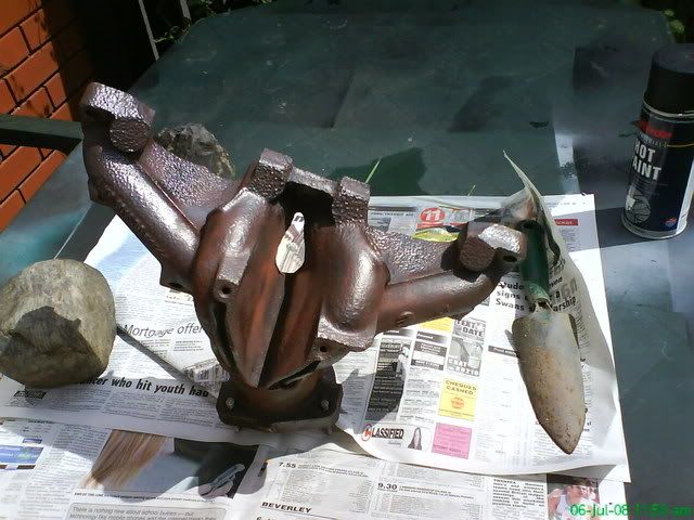

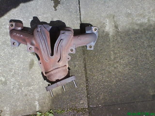

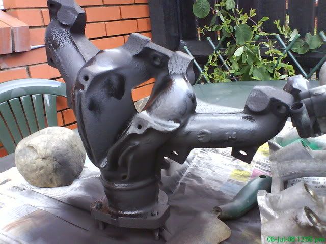

my exhaust was blowing where the manifold meats the down pipe, so I got a new gasket and some black heat paint as the manifold had to come off, so I thort I would spray it up so it tidys up the engine bay a bit, had a absolute nightmare trying to get the bolts of the bottom on the manifold, all the heads snapped off so when it was off, witch took a good 2 and a half hours, I had to drill them all out and then tap new thread in to the manifold, then I used thered bar though it,

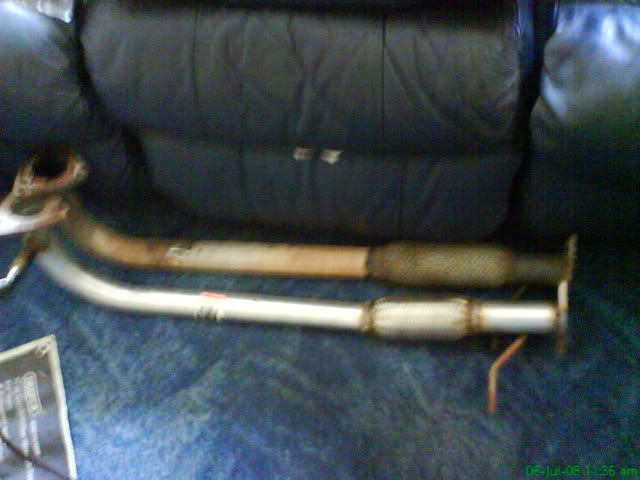

I also found that I needed a new down pipe as mine was gone around where the weld is around the flexi pipe
, I then set about rubbing back the manifold

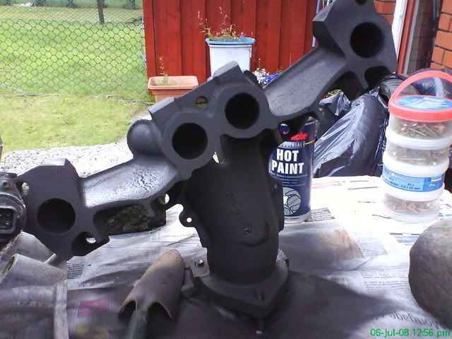

Then give it a coat or two of paint
Then while it was drying I went out and put the new down pipe on
will get some pics up later on when its all back on

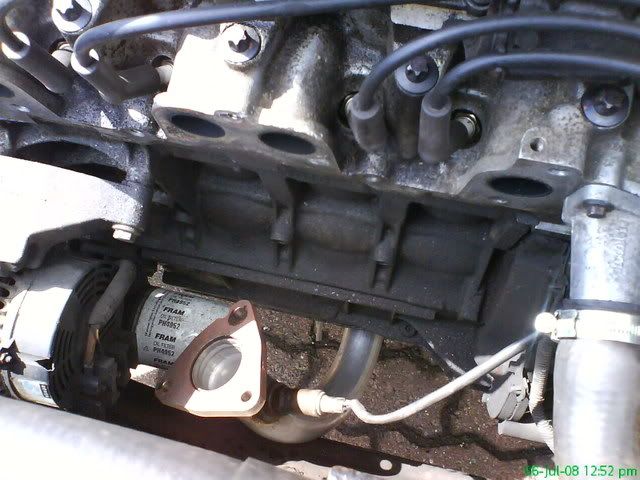

ok here it is all ready to go on

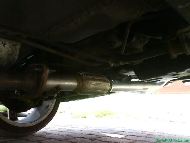

all on and bolted up:bounce:
, front with out the zr splitter
and with it all put back on
good news is its all back on, but the exhaust place gave me the wrong gassket where the down pipe bolts togather with the cat(or de cat in my case) so i had to use the old gassket so its still blowing down there
really not happy, so i am going to have to go down after work to moz and get the right gasket them swap it all over
